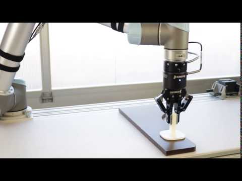

I was asked if a path that was recorded using the FT300 sensor on a Universal Robots could be played after removing the FT300 sensor from the robot's wrist. I was honestly not certain of the outcome, so I decided to test this idea. I recorded a simple path (the contour of a piece of furniture) with the stack of 3 Robotiq products (FT300 sensor, Wrist Camera and 2F85 gripper). I used a 3D printed tool to simulate the polishing of the part and recorded the path using the "Translation" mode in the Active Drive toolbar. Here is the result of the path recording:
https://www.youtube.com/watch?v=tX7Y8tznMEs

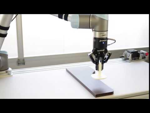

I then removed the FT300 sensor from the robot's wrist and reinstalled the camera and the 2F85 gripper. I then replayed the program without modifying any of the parameters. Here is the result:
https://youtu.be/MPytwKajGCk
As you can see, the tool has an offset in the Z axis. This offset is equal to the thickness of the FT300 sensor (31mm). This offset can be compensated in the TCP position.
