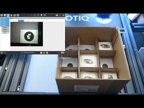

Problem
- Order preparation can involve a large variety of items which have to be picked form storage boxs. Detecting of objects in storage box is difficult. Teaching objects to a vision system is not really possible because of the variety of items and variety of orientation in storage boxs.
- Instead of detection the items themselves, the camera search background circle marks placed on each object placement of the box cardboard matrix. If a background circle is visible it means that there is not item in the placement. If it is not visible, an item is present and can be picked by the robot.
- The robot can validate box contents by reading a bare code on the side of the box.
- Each item box have its own cardboard matrix pattern. The robot adjust the program to match the carboard matrix pattern of the item.
- Background marks have to be place at the bottom of each box. It could be done with a paper placed at the bottom
- The robot is doing blind picking. It dive on item until sensing its surface and then activate the gripper. In this case the gripper is ePick but it could also be a Hand-e gripper for example. In some case blind picking may not be efficient
- Items have to be stored in boxes segmented by a cardboard matrix.

- The robot request the box it needs to process the order which have been set in the before program section.
- Using the camera the robot check if a box is present. To do that the robot chcek if it can see the big circle mark which should be hidden by the box.
- The robot verify the item available in the box by reading bar code on the side on the box.
- Using the camera the robot check if items are present in cardboard matrix placements and pick the requested quantity of items. To do that the robot checks on which placement small background circles cannot be seen.
- The program stop once all items of the order have been picked.

Here below is the picture of the type of storage box used for this demonstration.
The inside of the box is a cardboard matrix where are placed products. A circle is draw at the bottom of each placement. Using the Robotiq Wrist Camera, the robot search for placement where the background circle is hidden and dive on it to pick the object.
On the side of the box is an image on the product inside the box. The Robotiq Wrist camera use this side image to identify box contents and organization (product inside the box, pattern of the inside cardboard matrix,...). In this example I use an image but using a barcode would be more appreciate. The good thing is that the Robotiq Wrist Camera can read barcode !
