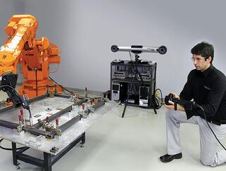

 2. MEASUREMENT
tracking dynamic high
This step is very important in the calibration process, since it allows for the collection of the data that will be used in the identification of the parameter errors. The measurement method and the instrument used depend on the identification approach. However, the most used methods involve measuring the position of the robot’s end-effector using 3D measurement devices, such as a laser tracker or a 3D camera system. You should choose your measurement tool very carefully, because it should be more precise than the robot's expected accuracy. This basically means having a measuring tool with a smaller uncertainty than the position resolution of the robot.
