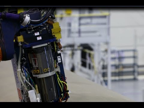

Many industrial applications require accurate robots to achieve critical tasks, such as aeronautic manufacturing [1] and metrological inspection [2]. However, industrial robots do not often offer height accuracy. Robotic inaccuracy is attributed to several error sources, which are divided into three main categories: Active joint errors, kinematic errors and non-kinematic errors. By active joints, we refer to the articulated and actuated joints of a robot, since some joints are articulated but not actuated, for example in parallel robots, these are called passive joints.
[1] At the heart of the CSeries
https://www.youtube.com/watch?v=lD25lilgGdo
We note that the active joint errors and the kinematic errors create the highest contribution to the lack of robot accuracy. As you can imagine, the non-kinematic errors have a higher impact on applications involving high payloads.
