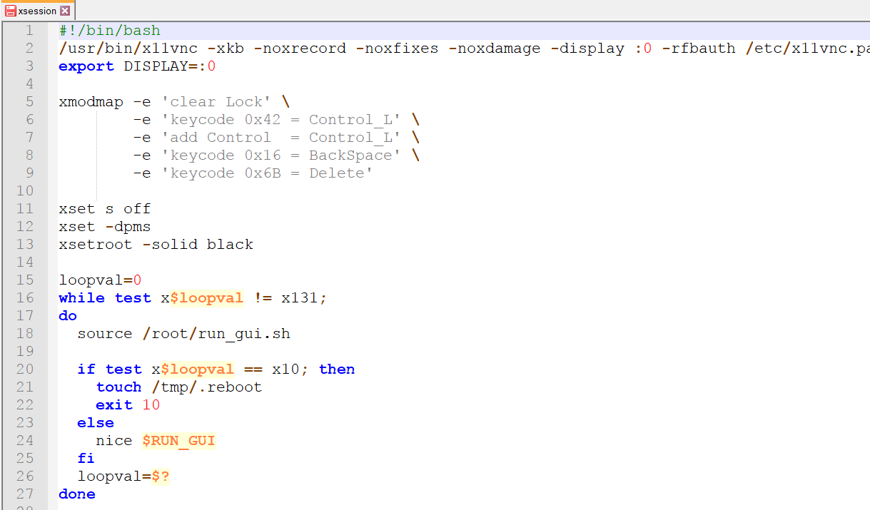

@thewave Where is the vnc command located in the xsession file. Can you post it?
Here is my xsession file
#!/bin/bash
/usr/bin/x11vnc -xkb -noxrecord -nofixes -noxdamage -display :0 -rfbauth /etc/x11vnc.pass -rfbport 5900 -forever -auth root -bg -o /var/log/x11vnc.log
export DISPLAY=:0
xmodmap -e 'clear Lock' \
        -e 'keycode 0x42 = Control_L' \
        -e 'add Control  = Control_L' \
        -e 'keycode 0x16 = BackSpace' \
        -e 'keycode 0x6B = Delete'
xset s off
xset -dpms
xsetroot -solid black
loopval=0
while test x$loopval != x131;
do
  source /root/run_gui.sh
  if test x$loopval == x10; then
    touch /tmp/.reboot
    exit 10
  else
    nice $RUN_GUI
  fi
  loopval=$?
done

My VNC log file from the xsession start:
20/01/2018 08:27:10 passing arg to libvncserver: -nofixes
20/01/2018 08:27:10 passing arg to libvncserver: -rfbauth
20/01/2018 08:27:10 passing arg to libvncserver: /etc/x11vnc.pass
20/01/2018 08:27:10 passing arg to libvncserver: -rfbport
20/01/2018 08:27:10 passing arg to libvncserver: 5900
20/01/2018 08:27:10 x11vnc version: 0.9.13 lastmod: 2011-08-10  pid: 2571
20/01/2018 08:27:10 Using X display :0
20/01/2018 08:27:10 rootwin: 0xae reswin: 0x400001 dpy: 0x83b2408
20/01/2018 08:27:10
20/01/2018 08:27:10 ------------------ USEFUL INFORMATION ------------------
20/01/2018 08:27:10
20/01/2018 08:27:10 Wireframing: -wireframe mode is in effect for window moves.
20/01/2018 08:27:10   If this yields undesired behavior (poor response, painting
20/01/2018 08:27:10   errors, etc) it may be disabled:
20/01/2018 08:27:10    - use '-nowf' to disable wireframing completely.
20/01/2018 08:27:10    - use '-nowcr' to disable the Copy Rectangle after the
20/01/2018 08:27:10      moved window is released in the new position.
20/01/2018 08:27:10   Also see the -help entry for tuning parameters.
20/01/2018 08:27:10   You can press 3 Alt_L's (Left "Alt" key) in a row to
20/01/2018 08:27:10   repaint the screen, also see the -fixscreen option for
20/01/2018 08:27:10   periodic repaints.
20/01/2018 08:27:10
20/01/2018 08:27:10 XFIXES available on display, resetting cursor mode
20/01/2018 08:27:10   to: '-cursor most'.
20/01/2018 08:27:10   to disable this behavior use: '-cursor arrow'
20/01/2018 08:27:10   or '-noxfixes'.
20/01/2018 08:27:10 using XFIXES for cursor drawing.
20/01/2018 08:27:10 GrabServer control via XTEST.
20/01/2018 08:27:10
20/01/2018 08:27:10 Scroll Detection: -scrollcopyrect mode is in effect to
20/01/2018 08:27:10   use RECORD extension to try to detect scrolling windows
20/01/2018 08:27:10   (induced by either user keystroke or mouse input).
20/01/2018 08:27:10   errors, etc) it may be disabled via: '-noscr'
20/01/2018 08:27:10 X FBPM extension not supported.
20/01/2018 08:27:10 X display is capable of DPMS.
20/01/2018 08:27:10 --------------------------------------------------------
20/01/2018 08:27:10
20/01/2018 08:27:10 Default visual ID: 0x21
20/01/2018 08:27:10 Read initial data from X display into framebuffer.
20/01/2018 08:27:10 initialize_screen: fb_depth/fb_bpp/fb_Bpl 16/16/1600
20/01/2018 08:27:10 *** unrecognized option(s) ***
20/01/2018 08:27:10 	[1]  -nofixes
20/01/2018 08:27:10 For a list of options run: x11vnc -opts
20/01/2018 08:27:10 or for the full help: x11vnc -help
20/01/2018 08:27:10
20/01/2018 08:27:10 Here is a list of removed or obsolete options:
20/01/2018 08:27:10
20/01/2018 08:27:10 removed: -hints, -nohints
20/01/2018 08:27:10 removed: -cursorposall
20/01/2018 08:27:10 removed: -nofilexfer, now the default.
20/01/2018 08:27:10
20/01/2018 08:27:10 renamed: -old_copytile, use -onetile
20/01/2018 08:27:10 renamed: -mouse,   use -cursor
20/01/2018 08:27:10 renamed: -mouseX,  use -cursor X
20/01/2018 08:27:10 renamed: -X,       use -cursor X
20/01/2018 08:27:10 renamed: -nomouse, use -nocursor
20/01/2018 08:27:10 renamed: -old_pointer, use -pointer_mode 1
My vnc log if i start it from SSH

thewave
if you put the export DISPLAY above the x11vnc command, does it works?
Its working now. It was my -nofixes option typo in the xsessions file.
