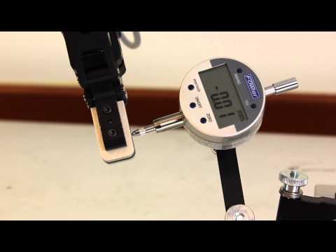

I would presume that it should have the same repeatability with the absolute encoders. That would be an interesting test to run, to e-stop the robot, start it back and see if it holds the same, or to have someone interfere with the robot and see what the numbers look like after resuming operation.

Hi pros,
one quick question, I saw a video showing the repeatability of the UR robot:
https://www.youtube.com/watch?v=9orN_aUDY7w
Listed in the specifications of the UR robot is a repeatability of 0.1mm. A question that we have been asked is that the video above shows that the robot is within the specs given. What if you turn off and then on the robot and try to run the same program. Would you still be within the limits or will the robot initialisation steps make this deviate a bit more?
