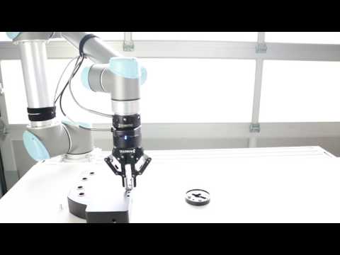

Here is the program I used for the demonstration:
Program
BeforeStart
parts≔0
Robot Program
MoveJ
Waypoint_1
Pallet
Pattern: Line
StartPos_1
EndPos_1
PalletSequence
Approach_1
Gripper Move 70%
Waypoint_14
Gripper Close
Waypoint_15
MoveJ
Waypoint_1
Camera Locate
If parts≟0
MoveL
Waypoint_3
Waypoint_2
Gripper Open
Waypoint_3
If parts≟1
MoveL
Waypoint_5
Waypoint_4
Gripper Open
Waypoint_5
If parts≟2
MoveL
Waypoint_7
Waypoint_6
Gripper Open
Waypoint_7
If parts≟3
MoveL
Waypoint_9
Waypoint_8
Gripper Open
Waypoint_9
Halt
Set parts=parts+1

Hi guys,
I was curious to see if I could use the vision system to find the through holes in a part. I tried teaching the M6 holes to the vision system, but I had to get very close to the part and this was limiting the field of view of the camera. So I decided to teach the entire part to the vision system, and I use an IF statement to teach several hole positions instead. I used a pallet function to pick up the 4 screws from the jig, and I used 4 IF statements to tell the robot where to insert the screws. In this demonstration, I am inserting the screws clockwise into the mechanical coupling.
https://www.youtube.com/watch?v=c6BjIs_UXtQ
As you can see, the part can be moved around since the vision system is looking for the part after picking up each screw.
*It would've been a good idea to use the aluminum fingertips without the silicone since the screws were sticking to the silicone!
