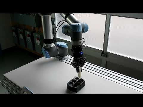

In a previous post, we did show you how you can use the camera and the path recording together by locating a part with the camera then incrementing the path recorded to fit the new position and orientation. This was explained in this post.
I wanted to do a proof of concept on how those features can be used in a gluing application, this can also work for other similar application such as finishing, deburring, etc. In brief, this example shows how you can use the camera to detect a part that isn't referenced on a plane and perform any located operation after.
Here is the video:
https://youtu.be/Yt3Jpq_Pr6Y
