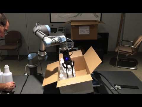

Hi @baghakian, interesting demo therefrom Numatic! I'm curious: what's between the FT sensor and the gripper?https://www.youtube.com/watch?v=NxS4KFCvfU0
@baghakian I wasn't aware that you could use a tool changer to facilitate the installation of end effectors. How do you manage the power of the gripper and the other end effectors when they aren't mounted on the robot? Do you remove the gripper's connections from the robot's controller? What kind brand of tool changer were you using in this demo?
