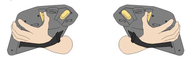

Many thanks @bcastets and @Etienne_Samson !
I think we will do something like that at this point. The CB3 robots does not have that good features for this kind of situations.
Have you heard that Universal robots starts to provide separately ordered teach pendant which has built in 3-position enabling device? That might be a good thing especially for the markets where UR robots is mainly used in situations where is safeguard monitoring.
Universal Robots 3PE teach pendant
