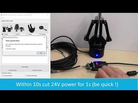

If for any raison someone change the communication settings like baud rate of your Robotiq gripper, you may lose capability to communicate with it. In such situation you have to recover your device using a PC and Robotiq User Interface (RUI) which you can download on Robotiq support page.Here below is a video showing how to complete this procedure:
