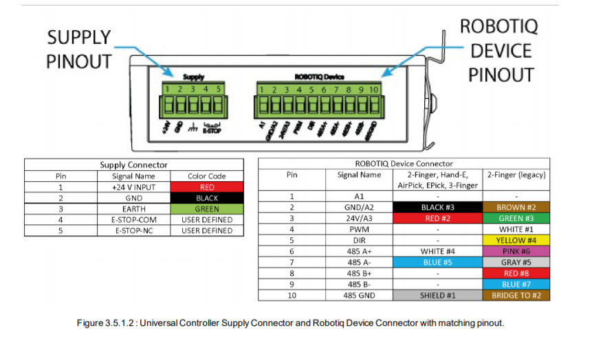

Hi Catherine,I was wondering if you could provide a wiring diagram containing the connection between the gripper and the KR C4 controller?Best regards,Mattia
Hello @MattiaHaas The Gripper must be connected to the universal controllerHere’s the schema of the connection:The Universal controller can then communicate with the robot, the communication port will vary depending on the communication protocol chosen : You can refer to the instruction manual for more details
