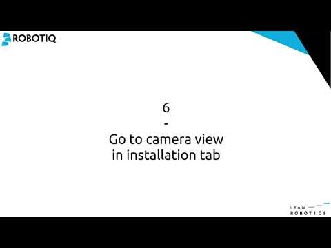

I would like to share with you a method to easily setup wrist camera position to fit calibration board.
To calibrate the camera, it is necessary to have it as parallel as possible to the working plane and have the calibration fit nearly 100% of the filed of view. Doing that by using teach pendant freedrive button is possible but orientation control is very difficult. Using the move interface is also possible but you have to switch between move and camera menu until reaching a correct position.
The method I propose use FT sensor functionalities:
