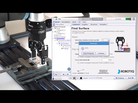

Hi Pros,Robotiq just released the new Find Surface Skill!This Skill is in replacement of the Linear Search Skill - Make sure to uninstall the Linear Search Skill before using the Find Surface Skill.The Find Surface Skill uses the Force Torque Sensor's data to detect a surface during a robot motion in a given tool axis. The user can insert various instructions after the surface is found: insert a part in a hole, find another surface, start a path, perform an object location sequence with a camera, open/close a gripper, etc.The user can default or edit a number of settings to better adapt the Skill to the application.https://www.youtube.com/watch?v=znNZsIMqSO4Browse to skills.robotiq.com to download the latest version of the URCap.Make sure to insert a Zero FT Sensor node before the Find Surface node to generate reliable results!Regards,
